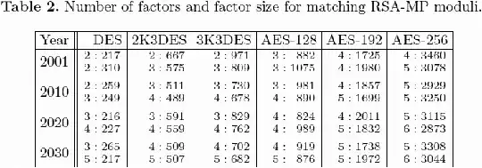

I know no standard about generation of RSA-MP key. However, for advice on the question of the bit size of $n$ and the number of factors $u$, one recommendable paper is Unbelievable Security: Matching AES security using public key systems, by Arjen K. Lenstra. See in particular the synthetic table giving $u:⌈\log_2\min(r_i)⌉$ for a given security level (in bits, with 2K3DES 95-bit), on a given year (with that parameter accounting for the author's evaluation of improvements on the algorithms, but not Moore's law), and according to two models.
table 2 from Unbelievable Security
Corrected: Following that size advice even at the 2K3DES level (for any entry starting Y2010), adding about $32/u$ bits per year to account for Moore's law (previously forgot that!), and choosing primes of one key randomly, my opinion is there's no need to worry about factorization attacks on that key till the Y2030 limit of that table. Notice that my endorsement assume that an adversary has no significant interest in factoring a single random key among extremely many.

The main things to consider regarding $\log_2n$, $\log_2r_i$, and $u$, are:
  • $n$ should be large enough that GNFS factorization is not to fear. Considerations are just the same for regular RSA and RSA-MP, since the multiplicity $u$ of factors, or their size $\log_2r_i$, does not influence the expected run time of GNFS; only $\log_2n$ matters.
  • Each $r_i$ should be large enough that $n$ is safe from factorization by known algorithms primarily influenced by the size of a factor extracted (rather than the size of the composite to factor), in particular ECM (among such algorithms, ECM is the most likely to factor one particular key). In regular RSA, it is customary to choose the two primes of equal (or nearly equal) size: this makes it overwhelmingly likely that GNFS subsumes all other known factorization algorithms, including ECM, by a large factor. However, that does not hold for RSA-MP; and while finding one $r_i$ does not by itself make it possible to forge signatures or decipher, it must still be considered a fatal disaster, for GNFS can then tackle the factorization of the composite $n/r_i$ at greatly reduced cost. Therefore, it is customary to choose the minimum size of a factor based on estimation of the running time of ECM (considered a function of $\log_2r_i$, often ignoring the relatively marginal influence of $\log_2n$).
  • Then the best choice of $u$ is ${\log_2n}\over{\log_2r_i}$, rounded in some direction.
For this, I trust the aforementioned Unbelievable Security.
Details on the choice should take into account that typically $⌈\log_2n⌉$ is prescribed, in which case we'll probably use $\log_2r_i\approx ⌈\log_2n⌉/u$; if not, there is often little or no performance cost in rounding up $⌈\log_2r_i⌉$ up to the next multiple of a word size, like 32 or 64 bits, then use $log_2n\approx ⌈\log_2r_i⌉⋅u$.
