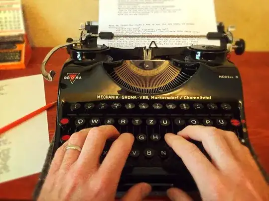

The key material for a OTP must be generated via a physical piece of hardware you can hold in your hand. It must be a physical process from the natural world, not the mathematical one. It can be levers in a double pendulum, thermionic valves or semiconductor junction breakdown. Everyone's favourite is radio active decay (although the only known instance of this is HotBits). It might actually be the hand itself. OTPs during WW2 were generated by ladies randomly typing at typewriters. But there has to be a hand involved somewhere. Oh, there's dice and dimes too, but you also use your hand.
Another way to look at it, is that entropy is handed to you. It comes in a physical piece of equipment, and all you do is measure it. You cannot make it yourself (not absolutely strictly true - but that's a more complex discussion). It has to look something like this:-
diode
or this:-
typewriter
