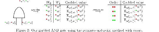

Permute-and-point
This trick works as follows: for each input and output wires $W_i$, Alice will concatenate a random bit $a\in \{0,1\}$ at the end of its garbled value $w_i^0$ and concatenate its inverse $b=\overline{a}=1-a$ at the end of $w_i^1$. So it allows to associate each of the 4 permutations of 2 bits to one of the entry of the GTT, without having any correlation between the bits and the values of the ungarbled truth table. So Alice can simply order the GTT according to the natural ordering and give it to Bob which will then be able to deduce which entry he should decrypt on a given input. To obtain a nice representation of this trick, those bits can be seen as a pair of colors, as I depict them in Figure 2, in which we see how the truth table is modified to take into account this method.
The permute-and-point trick
Those modifications allow Bob to simply decrypt the entry whose index corresponds with the colors associated to its input wires and thus to obtain the output wire's value and its color, allowing him to further evaluate the circuit.

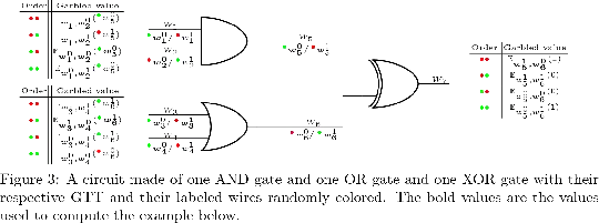

A circuit made of one AND gate and one OR gate and one XOR gate with their respective GTT and their labeled wires randomly colored. The bold values are the values used to compute the example below.
Let us see how one could evaluate the garbled circuit represented in Figure 3 using the permute-and-point method we discussed above. Let us assume that the semantic input values of $(W_1,W_2,W_3,W_4)$ are $(0,0,1,0)$, which means that the actual garbled input is $({\color{green}\bullet}{}w_1^0,{\color{red}\bullet}{}w_2^0,{\color{red}\bullet}{}w_3^1,{\color{green}\bullet}{}w_4^0)$ where the $w_j^i$ are the random values that Alice chose when she garbled the circuit, as seen above. Let us also assume that Alice already provided her garbled input, say $(W_1,W_3)$, and that Bob already obtained his garbled input $(W_2,W_4)$ from Alice through two applications of oblivious transfer as described in the protocol part.
So Bob will begin by evaluating first the AND gate using the input $({\color{green}\bullet}{}w_1^0,{\color{red}\bullet}{}w_2^0)$, since it has the colors $ \color{green}\bullet\color{red}\bullet$ he will try and decrypt the third entry of the GGT of the AND gate, which works and thus provide him with the garbled value ${\color{green}\bullet}{}w_5^0$.
Then he can continue his evaluation with the second gate, which is the OR gate. He looks at its input $({\color{red}\bullet}{}w_3^1,{\color{green}\bullet}{}w_4^0)$ and try to decrypt the entry corresponding to $ \color{red}\bullet\color{green}\bullet$ with the keys $(w_3^1,w_4^0)$, it decrypt into the garbled value ${\color{green}\bullet}{}w_6^1$.
He can now decrypt the final XOR gate using the computed input $({\color{green}\bullet}{}w_5^0,{\color{green}\bullet}{}w_6^1)$, thus decrypting the $\color{green}\bullet\color{green}\bullet$ entry which provide him with the final result: "1".
And Bob does not know what was Alice's input, he just knows the final output "1" and the randomly generated strings $w_1^0,w_2^0,w_3^1,w_4^0,w_5^0,w_6^1$. He can still for example deduce from the circuit that the semantic values of $w_5^0$ and $w_6^1$ are opposed, however it does not allow him to reverse the garbled circuit up to Alice's input values. There are circuits where no privacy is assured, like for example a circuit computing the sum of the inputs, however in this example case, Bob—knowing his semantic input values—can simply restrict Alice's inputs to a subset of the possible inputs but cannot uniquely determine the actual Alice's input values.
