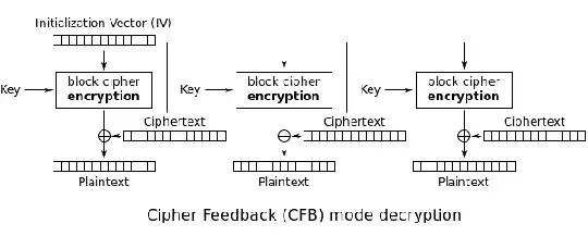

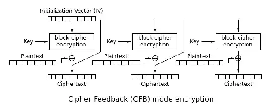

Yes, CFB just takes the previous block as the IV for the next block making it a stream cipher.
If you modify your iv_dec equal the result of the previous block, however long that is, it should work.
aes-cfb encrypt
Perhaps my answer was confusing because the image included above was for encryption and your asking about decryption.
aes-cfb decrypt
images from Wikipedia
