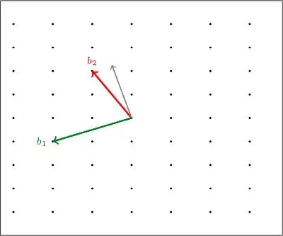

The issue with the length-reduction criterion alone (and the reason the Lovász condition is included in the LLL algorithm) is that the following basis satisfies it:
A length-reduced lattice basis
(The grey arrow is the projection of $b_2$ to the orthogonal complement of $b_1$.)

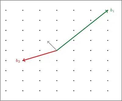

Clearly, this basis is not very short, nor is it close to being orthogonal (i.e., note that length reduction alone does not imply almost-orthogonality!). The Lovász condition is suited to detect such a situation: If the order of the vectors is swapped, another length reduction can easily be performed, yielding the following LLL-reduced basis:
A LLL-reduced lattice basis
It seems that Lenstra, Lenstra, and Lovász have noticed that a situation in which length reduction alone is stuck with a very bad basis — as depicted in the first image — always has vectors which are in the "wrong" order comparing their lengths and which are far from being orthogonal, and that it helps in this case to exchange them and continue length-reducing.¹ That is really the core idea of the LLL algorithm.
I think of the Lovász condition mainly as a technical construction that just "turned out" to work well, but by rearranging the terms, one may get a feeling for why it enforces close-to-orthogonality:
$$ (\delta-\mu_{i+1,i}^2)\lVert b_i^\ast\rVert^2 \;\leq\; \lVert b_{i+1}^\ast\rVert^2 $$ (In your formula, $\delta=1$ is "hardcoded".)
The Gram-Schmidt coefficient $\mu_{i+1,i}$ measures the angle between $b_i^\ast$ and $b_{i+1}$; the angle is small iff $\mu$ is close to $1$, and it is large (i.e. almost orthogonal) iff $\mu$ is close to $0$. Note this talks about the angle between the orthogonalized vector $b_i^\ast$ and the lattice vector $b_{i+1}$, but $b_i^\ast$ is in turn forced to be "quite close" to $b_i$, hence this also bounds the angle between the lattice basis vectors depending on the orthogonalized vectors' lengths relative to each other.
In short: The Lovász condition is fulfilled if the vectors are close enough to being orthogonal, or if they are roughly ordered by length. Both of these properties lead to length reduction being quite effective.
