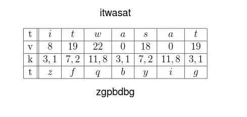

A polyalphabetic affine cipher can be seen as the composition of an affine cipher ($p \mapsto c \equiv a \times p + b \pmod{26})$ and a Vigenère cipher.
Consider we have a key such as $(a_{n\ mod\ 3},b_{n\ mod\ 3}) \in [(3,1); (7,2); (11,8)]$.
For instance itwas$_{plaintext}$ $\longrightarrow$ zgpbd$_{ciphertext}$. enter image description here
