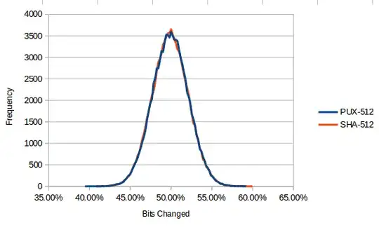

I've done it this way for SHA 512:-
  1. Generate a random number 512 bits long, called O
  2. Randomly flip one bit to generate number F
  3. Compute X = SHA(O) xor SHA(F)
  4. Calculate no. of set bits in X
  5. Coefficient Ksac = X /512 (note)
  6. Rinse and repeat a million times to get a mean for Ksac
(note) Should this be an integer division?
This is the result I got for comparing SHA 512 to a DIY hash function for 100,000 tests:-
Avalanche effect coefficient for SHA 512
P.S. I think that Gupta & Yadav have made up this metric themselves, but it's a good one.
P.P.S Whilst Ksac is a good one, I'm worried at their results. Their Ksac(SHA-256) is 8% out from the expected value. I performed millions of runs as it only takes minutes. Perhaps they only did 100. Or perhaps SHA-256 does not exhibit full avalanche effect and they're really on to something big. Either way, I would have expected discussion of the 8% as that's approaching a 1/10th divergence from expectation. The paper seems quite light, and I suspect that it's a Masters dissertation rather than research.
