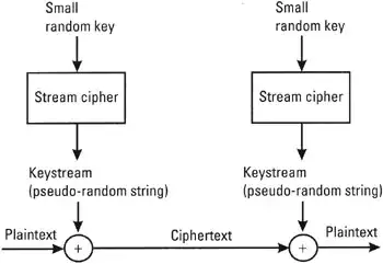

If you use AES-CTR as a stream cipher (see more here), you will specify a key $K$ (and a nonce $IV$). The CTR mode of AES will generate a stream of bits, whose length matches the messages. All that is required is to XOR it with the message.
In order to decipher. One will require the key $K$ (or nonce $IV$), regenerate the stream and XOR to retrieve the plaintext.

One of the requirement of the Perfect secrecy is the key space has to have the same size as message space. Hence the key and the message must have the same length. In the OTP or Vernam Cipher, this is the case. In a Stream cipher, given that the key is used to generate a stream, whose length is greater, it does not meet the Perfect Secrecy requirement (while still being reasonably secure).

As Shanon proved in his famous paper, the important need a cipher to be a perfect cipher is: the length of the key be larger or at least the same as plaintext.
In the stream ciphers like other ciphers, the length of the key is very short and we can not build a key in practice be the same or larger of plaintext. In stream ciphers, a key will produce a keystream that this keystream may be long but it is not infinite and after some periods will be finished.
In other words, we can say the only perfect cipher is OTP (One Time Pad) and producing this pad that is random is not practical and if could produce, we can not transfer it through an unsecured channel (because if we could transfer this long key, we could transfer the own plaintext).
So stream cipher and other ciphers that are practical and we are using in the real world, are not perfect ciphers, They are computational ciphers,though.
