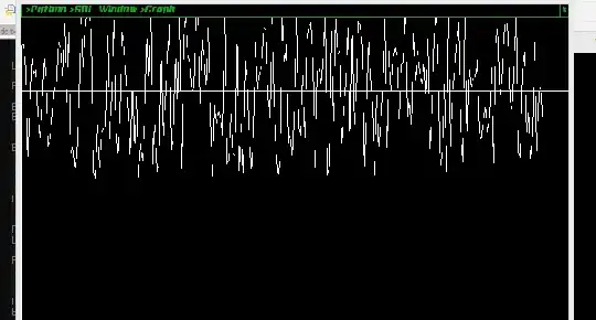

Upon further consideration of the simplest example of a 1 byte state, I realized that, for a 1 byte state, the function basically produces the same noise wave. A different input is to the function is equivalent to selecting a different starting point on the wave, and recursive calls just cycle forward through the wave one point at a time.
The initial state could be determined by recording 2 ** 8 outputs, or the entire cycle. Technically, for a one byte state, just knowing the one output allows you to know the previous one, and by extension all the ones before that.
However, I am not exactly sure how this train of thought extends to a multiple byte input state. I'm not sure if the same wave is generated with the difference being where on the wave it starts, or if different noise waves are generated by differing combinations of bytes. I conjecture the latter, as some combinations of input bytes do not have the same cycle length. I'm also not sure how to extend this idea beyond capturing all of the output bytes and finding which seed produced that particular order.
I graphed the noise wave for the one byte cycle, if anyone is curious to see it:
noise wave

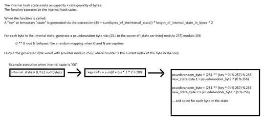

Permutation explained (as mentioned in the comment area):
