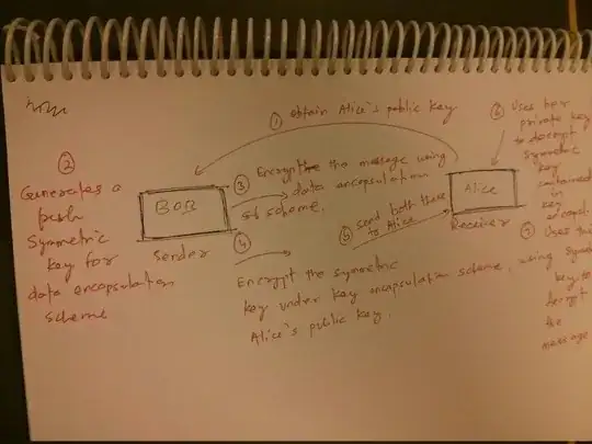

Steps of Hybrid Encryption:
To encrypt a message addressed to Alice in a hybrid cryptosystem, Bob does the following:
  • Obtains Alice's public key.
  • Generates a fresh symmetric key for the data encapsulation scheme.
  • Encrypts the message under the data encapsulation scheme, using the symmetric key just generated.
  • Encrypt the symmetric key under the key encapsulation scheme, using Alice's public key.
  • Send both of these encryptions to Alice.
To decrypt this hybrid ciphertext, Alice does the following:
  • uses her private key to decrypt the symmetric key contained in the key encapsulation segment.
  • uses this symmetric key to decrypt the message contained in the data encapsulation segment.
