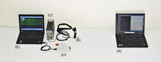

setup
image source: https://www.cs.tau.ac.il/~tromer/acoustic/

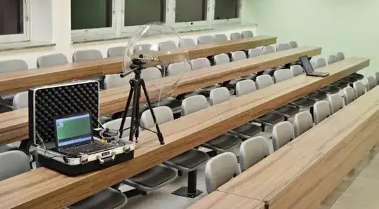

The proof in that 57-page paper is hard enough to start thinking about related crypto-solutions. Especially since the paper mentions that rather simple hardware like parabolic microphones and laser vibrometers can be used for distant acquisition.
equipment

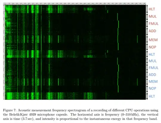

visualized cpu instructions
