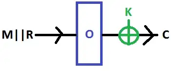

Assume:
  • $O$ be a reversible random permutation oracle on a finite set and $O^{-1}$ the inverse permutation (pretty much equivalent to a random permutation: What is the difference between a bijective random oracle and a random permutation?). Here, the attacker can call both $O$ and $O^{-1}$ on any input
  • $M$ be a fixed-length message to encrypt
  • $R$ some fixed-length random data. A new $R$ is generated every time you want to send a message
  • $K$ the secret key ($|K|=|M|+|R|$)
  • $C$ the encrypted message
  • $||$ the concatenation operator
Design:
draft
Encryption:
  • Generate $R$
  • Apply $O$ to $M||R$
  • Xor the result with $K$
  • Send the output $C=O(M||R)\oplus K$. $R$ is not sent.
Decryption:
  • Xor $C$ with $K$
  • Apply $O^{-1}$ on the result
  • Remove $R$ (easy since $R$ has a fixed length)
  • Enjoy $M=MSB_{|M|}[O^{-1}(K\oplus C)]$
As long as $R$ is long enough, is this design secure? Why?
I think that any attack that requires more than $2^{|R|}$ queries of the Oracle should be viewed as infeasible.

Given:
  • The attacker can call PRP() and the inverse function prp() on any message of his choosing.
  • PRP is a pseudorandom permutation indistinguishable to the attacker from a random permutation.
  • Assuming R and K are "sufficiently large", perfectly random, and never leaked to the attacker -- in particular, during a chosen-ciphertext attack, the decryptor only gives the message M to the attacker, never leaking the value of R.
passive attacks
It appears at first glance that this construction is secure against a polynomial-time Eve, a passive eavesdropper, even under both a chosen-plaintext attack and chosen-ciphertext attack, in the sense that the attacker can't decode any other encrypted messages (other than the ones you allow him to decode during the chosen-ciphertext attack).
                    K
M||R----->[PRP]--->(+)---->C
active attacks
Because there is no message authentication code, an active attacker can conduct a replay attack.
If the "message" part is allowed to be short -- for example, 2 bytes long, an attacker who can trick the system into encoding all possible 2 byte messages, or decoding a few hundred thousand random values, can make a collection of ciphertexts that he knows corresponds to each possible 2 byte message. Because there is no message authentication code, an active attacker can inject any such such message of his choosing -- "Ya", "No", "Hm", etc.

                K
M||R---[PRP]---(+)--->[PRP]---->C
the Even-Mansour scheme:
        K              K
M||R---(+)-->[PRP]--->(+)---->C

The scheme is secure against chosen-plaintext attacks up to $2^{|R|/2}$ queries. Indeed, given this number of queries, it is likely that every encryption call yields a new value $R$, which has never used as part of the permutation input.
However, when this bound is reached, some problems occur. Suppose you encrypt the same message $M$ as many as $T=2^{|R|/2}$ times. Then it is likely that there is a collision in suffixes $R_1,\ldots, R_T$. Such a collision implies two identical permutation inputs and two identical ciphertexts, which is highly unlikely for $|M|>10$ and thus distinguishes the cipher from a random permutation.
