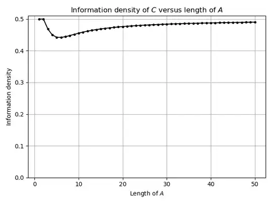

The information content appears to be perfectly linear as the length of $A$ (where all $a_m = 0.5$) increases, but plotting information density is below:
Information density of <span class=$C$ versus length of $A$" />
Note that, as the length of $A$ increases significantly beyond this plot, it appears to converge back up to 0.5.
Please can someone demystify what's going on here? Why the dip in the graph? Am I fundamentally misunderstanding what information means or how to quantify it?

The probabilities of the two bits in the question's $a=\{0.5, 0.5\}$ are independent, for $A$ uniformly random in $0$, $1$, $2$, $3$. But the probabilities of the three bits in $c=\{0.5,0.5,0.25\}$ for $C=A+1$ are not: when $c_2=1$, it always hold $c_0=0$ and $c_1=0$. That's why we can't compute the (Shannon) entropy in $C$ by adding the entropy in it's individual bits, as the question attempts: this is valid only for independent bits.
Note: I kept the question's notation, which uses the set notation $\{0.5, 0.5\}$ for a vector of probabilities.
Also, the entropy for a one-bit variable set with probability $p\in(0,1)$ is $E(p)=-p\log_2(p)-(1-p)\log_2(1-p)$ bit, rather than $E(p)=-p\log_2(p)$ as (I think) the question considers.
The entropy calculations in the question are thus incorrect. When conducted correctly, we get that there is exactly the same entropy in $C=A+1$ as there is in $A$, that is $2$ bits. That is:
  • $A$ can take equally likely values $0$, $1$, $2$, $3$; these outcomes have respective probabilities $p_0=p_1=p_2=p_3=1/4=0.25$, thus entropy is $\displaystyle-p_0\log_2(p_0)-p_1\log_2(p_1)-p_2\log_2(p_2)-p_3\log_2(p_3)=2$ bit.
  • $C=A+1$ can take equally likely values $1$, $2$, $3$, $4$; these outcomes have respective probabilities $p_1=p_2=p_3=p_4=1/4=0.25$, thus entropy is $\displaystyle-p_1\log_2(p_1)-p_2\log_2(p_2)-p_3\log_2(p_3)-p_4\log_2(p_4)=2$ bit.
