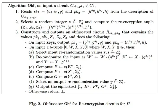

After that, they proposed a re-encryption obfuscator that satisfied the above definition. Let's say construction A:

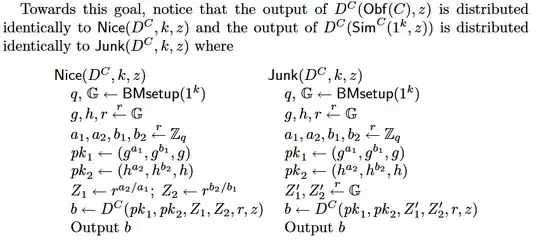

the first construction But this work (by Ateniese, Benson, and Hohenberger) found that construction A does not preserve key private property. Given the re-encryption tuples from Alice to Bob and from Bob to Alice, the adversary can tell if the two re-encryption tuples are matched! For example, given $(Z_1,Z_2,Z_3) = (h^{za_2/a_1},h^{zb_2/b_1},h^z)$ and $(Z_1',Z_2',Z_3') = (g^{z'a_1/a_2},g^{z'b_1/b_2},g^{z'})$, $\mathcal A$ checks if $e(Z_1',Z_1)==e(Z_2',Z_2)==e(Z_3',Z_3)$. This evidence shows that this construction A is not a secure obfuscator in their definition: the adversary gains additional knowledge! And, in their security proof, the simulation is distinguishable since the adversary can do the matching check: part of the security proof
