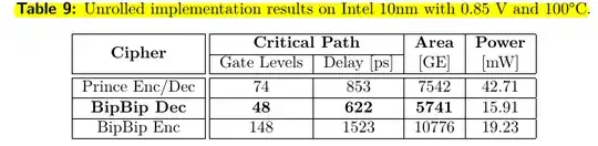

It seems that the BipBip authors are completely unaware of this, as the invertibility of their tweak schedule is never mentioned throughout the paper. However, it clearly shows in their latency benchmarks, which show the encryptor being much slower as a direct result of having to run the tweak schedule in it's entirety.
BipBip latency benchmark
Invertibility has much faster latency, allowing a tweak schedule to run in parallel with the datapath of the encryptor. I plan on writing a paper that covers this latency difference in much more detail. I will also attempt to propose an inverse tweak schedule to allow BipBip's encryptor to have a similar latency to the decryptor.
Non-invertibility seems to not have an effect on security, and now that I know $\chi$ is actually invertible, BipBip's tweak schedule has no reason to be non-invertible, and it simply makes the encryption slower.
