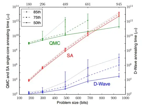

They did experiments with up to n=10 qubtis, which means that the 10 qubits would be represented by vertices of a $K_{10}$ graph, and ZZ interactions would be needed between all possible pairs of these qubits. That's not hard, but to do RSA-2048 they say that they would need 372 qubits and therefore the $K_{372}$ graph. Having 372 qubits each interact with 371 other qubits is not likely to happen in the next decade (or 7 decades, as the next paragraph explains) without significant losses in performance elsewhere.
In the first five commercial quantum annealers sold by D-Wave, each qubit could interact with at most 6 other qubits. Recently they released a device, for which my team reverse-engineered the connectivity graph based on whatever few sketches they made available at the time, and it had each qubit interacting with at most 15 other qubits. They claim to be extending this to 20 qubits in 2023-2024, but even if they add 5 qubits per year it will take more than 70 years for them to have each qubit interacting with up to 371 qubits. Machines with all-to-all connectivity have been proposed though, for example the coherent Ising machine and the "digital annealers" made separately by companies like Fujitsu and Hitachi, however I'm not aware of any graphs like the D-Wave ones below, which show orders of magnitude speed-up from these devices over "classical" computation.

In the world of QUBO, 372 is not a lot of bits/qubits. In the reference list of my book on quadratization there's many papers that show you that they solved real-world QUBO problems involving 20,000 bits (i.e. binary variables). However there's two important points to make about that:
  • 372 bits with all-to-all coupling is much harder than 20,000 bits with each bit only interacting with a handful of other bits (as would be the case in the the above-mentioned references).
  • Finding the global ground state is much harder than finding a state whose energy is close to the ground energy (the above-mentioned references are for a computer vision problem, in which the goal is to get an image that closely resembles an "original" image, meaning that an approximation of the ground state is "good enough" as long as it gives an image that matches to the extent that our human eyeballs can notice).
Nevertheless, I need to "call out" the use of 2^n in that comment for at least two reasons, the strongest being described in bullet points below:
  • As mentioned in the same author's subsequent comment here, Grover's algorithm makes the cost $2^{n/2}$ rather than $2^n$, which for $n=372$ is the difference between $10^{112}$ and $10^{56}$. That's a difference that seems unfair to ignore when talking about actual factorization of real integers, as opposed to a theoretical study of what happens to things inside a big-O when $n \rightarrow \infty$.
  • Finding the global minimum of a binary optimization (QUBO) problem with 372 variables does seems hard (depending on how many copies of it exist; if the function is constant then every input gives the minimum). However, no classical computer has ever factored RSA-260 (862 bits) yet. This would be 2*862/log_2(862) = 177 qubits which would be 2^(177/2) or 5 x 10^26 operations to find the ground state with Grover's algorithm in the worst case scenario. There's so much that can be done to reduce the number of qubits using pre-processing for example in the way I did here, but let's pretend we don't do any of that. 10^26 is only 8 orders of magnitude larger than exascale computing and the zettascale computing that we can reasonably expect to see next decade. Combine that with the fact that single-core D-Wave devices have already been shown to be about 7 orders of magnitude faster than single-core classical computers in this study (remember that we're looking at 177 bits on the x-axis to factor an RSA number that a classical computer has never yet been able to factor):
Therefore if only considering the 2^n or 2^(n/2) QUBO complexity, then a feasible-sized fleet of quantum annealers with 177 qubits each, and capable of getting the Grover speed-up that adiabatic "annealers" have been proven to be able to achieve, could factor RSA-260/RSA-862 with this algorithm while a next-decade zettascale supercomputer would not be able to find the associated QUBO minimum classically in the same amount of time. If we were considering a problem that could be solved with a graph connectivity more similar to the quantum hardware (rather than with the "complete graph" mentioned in my "Graph complexity" section above), then dismissing quantum annealers due to the QUBO complexity at this number of qubits would be dangerous because the functional form of the complexity is not the only thing that matters, constants do matter.
Allow some pre-processing and problem-specific optimizations to reduce the number of qubits, and n=177 qubits goes down, along with 2^(177/2). Allow the user to do something better than the most blind, naive, brute-force search, and the 2^n required to find with a guarantee the global ground state (assuming there's only one copy of it!) goes down too. Even on classical computers, the GNFS isn't run with a random polynomial, they spend time finding a polynomial that is good for the specific number that they're factoring. We have to allow the people factoring by optimization (whether on classical computers or quantum annealers) to do better than "brute-force" search.
