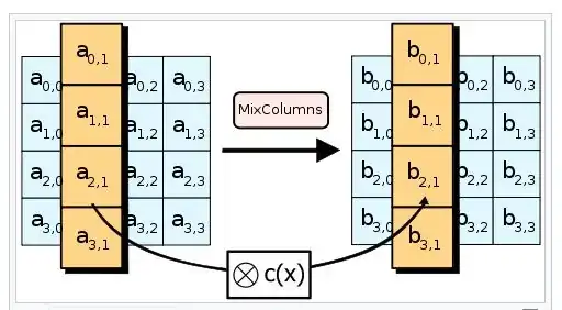

In the case of AES, the use of MDS codes means that 5 of 8 bytes are always "active" (the minimum weight/distance of the MDS code with parameters $[n,k]=[8,4]$ is $d=n-k+1=5.$) This means that you get diffusions (maximum possible under linear mixing due to the MDS bound on $d$) of the type
  • 1 nonzero byte (of the $(a_{i,j})_{i=1,\ldots,4}$) going to at least 4 nonzero bytes (of the $(b_{i,j})_{i=1,\ldots,4}$)
  • 2 nonzero bytes (of the $(a_{i,j})_{i=1,\ldots,4}$) going to at least 3 nonzero bytes (of the $(b_{i,j})_{i=1,\ldots,4}$)
  • 3 nonzero bytes (of the $(a_{i,j})_{i=1,\ldots,4}$) going to at least 2 nonzero bytes (of the $(b_{i,j})_{i=1,\ldots,4}$)
  • 4 nonzero bytes (of the $(a_{i,j})_{i=1,\ldots,4}$) going to at least 1 nonzero bytes (of the $(b_{i,j})_{i=1,\ldots,4}$)
in each of the columns in MixColumns.
To explain further, the Singleton Bound Wikipedia states that for any code over a symbol alphabet with $q$ elements, the minimum distance (and thus for a linear code the minimum weight, i.e., the number of nonzero components) satisfies $$ d\leq n-k+1 $$ where $n$ is the length of the codewords, $k$ is the dimension of the code. MDS is maximum distance separable, i.e., optimal, i.e., the largest possible minimum distance for given $n,k$ parameters.
We have $q=2^8,$ here since we consider each byte as a code symbol. Since the column of $b'$s is obtained by multiplying the column of $a$'s with an MDS matrix the two columns form codewords in this code. Thus $d=n-k+1=5$ thus at least 5 of the bytes in the $b$'s column and the corresponding $a$'s column are guaranteed to be nonzero.
This is an algebraic design. In the Skein spec they use the somewhat strange expression 5 full diffusions for AES, presumably related to this value of 5 nonzero bytes.
See here for more details on the AES mixing design.
