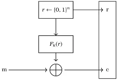

I think you are missing the idea of randomness as part of a cryptographic application. It is not possible to create CPA-IND- order CCA-IND-security with a deterministic encryption scheme. Only by adding randomness, as an additional ephemeral secret key, those level of security can be archived.
Here is a very simple scheme (you can find it in Katz & Lindell's textbook (2nd edition)), which can be proven to be CPA-secure. $r$ is the needed randomness and $k$ is the standard secret key. $F$ is a pseudo random functions (based on $r$ and $k$)
