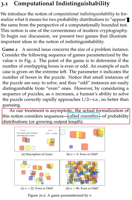

I'm currently reading this classic paper "How To Simulate It" and on most of the definitions it is using the term probability ensemble to represent the message space. From my understanding a probability ensemble is like a stochastic process and a probability distribution is an instance of a stochastic process. For example, if we have $\{X_n\}_{n \in \mathbb{N}}$ then we can consider it equivalent to $X(n)$ where $n \in \mathbb{N}$ and $X(5)$ for example is an instance of the probability ensemble, a probability distribution.
I'm kind of confused about why we need to consider this structure for the plaintext space. Actually, it would make more sense to me since we consider a non-uniform $PPT$ to consider this structure as the ciphertext space, but probably this isn't the case. Can you help me clarify this?

As for $\{X_n\}_n$ vs $X(n)$, I would just say one reason to not consider probability ensambles as stochastic processes is that there is no reason to expect $X(n)$ and $X(n-1)$ to be connected in some way (say be martingale, or have any other property a stochastic process might typically have). The main property you want from whatever way you formalize things as is a mapping from integers to probability distributions, so you can coherently use the notion of "negligible" functions (where $f(n)\in\mathsf{negl}(n)$ if $f(n) = n^{-\omega(1)}$), which are very useful for analysis. This is really only relevant for asymptotic security though, for concrete security you'll typically set $n = 128$, and not work with arbitrary neglible functions (such as $f_0(n) = 2^{-(\log n)^2}$), and instead work with explicit inverse exponential functions ($f_1(n) = 2^{-n}$).

It was explained by Rafael Pass and Abhi Shelat in "A Cource in Cryptography", [PS2010'Section 3.1: Computational Indistinguishability]

Your understanding of an ensemble in this context is incorrect. An ensemble in this context is a sequence of probability distributions.
Given two probability distributions $X, Y$, you can consider the best-possible distinguishing probability (for distinguishers running in some bounded time) between a random sample from $X$ and a random sample from $Y$. You will get a number, and that is fine for concrete security. But if you want to consider asymptotic security, then you need to consider two infinite sequences of probability distributions $\{X_i\}_{i =1, \ldots}, \{Y_i\}_{i =1, \ldots}$ where the distributions are indexed by the security parameter.
I suggest looking at Katz-Lindell, "Introduction to Modern Cryptography (3rd edition)." They discuss this issue in Section 3.1 and more formally in Chapter 8 (especially Section 8.8).
