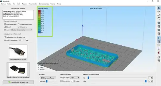

Trying to print a 3D model for my mobile phone, but I see that when printing the sides, being thin, increases the retraction and the recoil seems a little abrupt and makes a coarse sound.
I would like to know if it is possible to know what speed and temperature is recommended to print a model.
In my case I use Simplify3D, and when I'm going to save the file in .gcode format, I see that there are some ranges shown in colors, how does this apply to the models?
Screenshot of Simplify3D

The first indication for print speed and temperature should be taken from the box the filament comes in. Generally it specifies temperature ranges for the hotend and the heated bed. Sometime, mostly online, more parameters can be found amongst which is the printing speed.
Do note that temperature and printing speed are linked, if you want to print faster you should increase the temperature. But, if you are printing small or thin things you should print slower so that the part cools enough for the next layer. Basically, part cooling is then also important, but not all filament types (e.g. the ones with a high melt temperature like ABS or PETG) like being cooled too much. So you have another parameter to consider.
It is difficult to instruct you to print at a certain speed and certain temperatures as it is highly depending on the filament (e.g. also the filament diameter), the machine type/make and model, extruder setup (direct or Bowden), the print, enclosure, etc.
Because of the many parameters affecting printing, it is usually suggested to calibrate the printer by printing a temperature tower or performing retraction tests to find the print window for your specific setup.

So as someone else on here mention, those settings shouldn't be for the model but for the filament. Sadly, you will need to test 99% of filaments to really figure this out. I have a modify tester, and on the description it tells you how to set your temp. https://www.thingiverse.com/thing:3347967
You can look at the remix if you want to grab the blank model and put your own numbers on it. It should be noted that things like water in the filament can mess with how the filament reacts to speed and temp. If you have questionable prints coming out of a filament that sat there for a long time. You can easily run it through the test to figure out the temp.
Anything else I could add is would just repeat what most of 0scar said.
