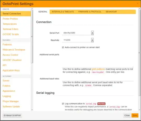

Serial logging has to be enabled. Warning: This will impact the performance of OctoPrint. Enabling this feature can be done under Settings -> Serial Connection -> Serial Logging and checking the box for "Log communication to serial.log. OctoPrint Settings
One can download the log under Settings -> Logging and finding serial.log in the list of log files.
