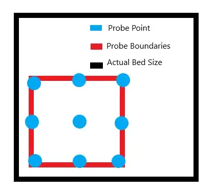

I have just installed the BLTouch on my Ender 3 running Marlin 1.1.9 and I want to set it up so the probing does the 9 points in a perimeter that uses most of the bed surface area. At the moment the probe just covers a small area.
I read that to sort it out you have to change the section " // Set the boundaries for probing (where the probe can reach)." but I can't figure out what to set it as, my current settings are as follows:

As explained in this answer it is you that needs to calculate where the head (read sensor) is supposed to go depending on the amount of space you have left on the carriage shafts.
As can be seen from your configuration, your sensor is located on the left front (when facing the machine) at 41 mm left from the nozzle you are requesting the sensor to travel to a position that is outside the bed (35 mm), so you should at least subtract 41 mm from your X bed size.
As you have not posted a bed size, an assumed X bed size of 220 mm would mean that the maximum probing distance for X (i.e. RIGHT_PROBE_BED_POSITION) of 220 - 41 = 179 mm
In your case -41 mm would take it to the edge, so 30 mm extra would make it symmetrical:
#define LEFT_PROBE_BED_POSITION 30
#define RIGHT_PROBE_BED_POSITION (X_BED_SIZE - 41 - 30)
#define FRONT_PROBE_BED_POSITION 30
#define BACK_PROBE_BED_POSITION (Y_BED_SIZE - 5 - 30)
