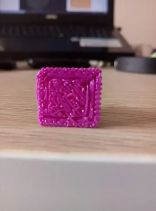

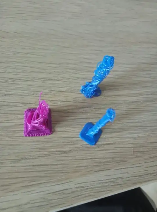

Recently I bought a Prusa i3 pro W (from Geeetech) and I've been struggling with something that is ruining all my printings. I attach a photo with what was supposed to be little "boxes":

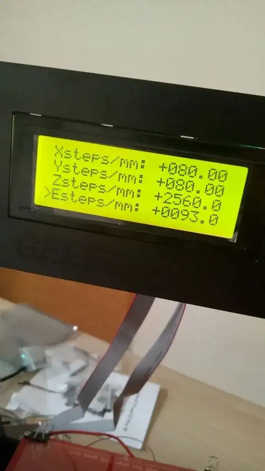

Controller display
As you can see the Z distance is doing weird things, I think may can be fixed through this configurations, as it seems the Z axis is moving too much:
On the other hand, the form the printer is doing the skirt is also bothering me, I've tried a lot of configurations and I think it's a problem of over extrusion, but I'm a newbie and I don't really know what more could I do...
Close up of failed print

  1. as per base of the pink printout it looks like the bed is far below the nozzle (level the bed)
  2. to check the Z steps/mm setting, the best way will be to home it, then from menu move Z by 50mm and check with a ruler or meter traveled distance.
  3. then using a formula (requestedMove/measuredMove) * currentSteps set new value in to Z steps/mm setting. After that repeat the exercise until you will get no difference.
