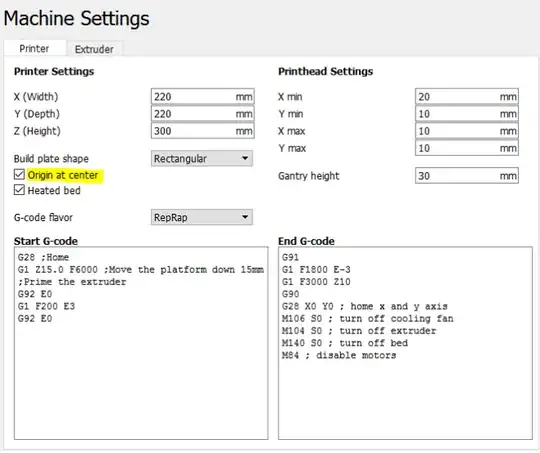

I tried printing a calibration cube. The first problem I noticed is that the printing is starting on one corner instead of the center as specified on the Printer Settings in CURA (check settings below).

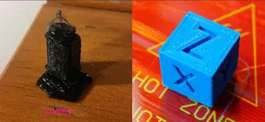

Second problem is that I'm getting significant distortion. The movement of the printer seems to be fine, no jerks of weird sounds. I tried all I know but I honestly don't know how to proceed with this. I have a couple of hours of experience in 3D Printing so I'm completely lost.
This is the result I got (Model printed with Raft for adhesion):

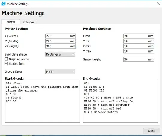

These are my CURA settings:
Printer
CURA settings - Printer
Extruder
CURA settings - Extruder

The first problem is solved by removing the tick mark at Origin at center. Most printers have their origin at a corner (not Delta's, their origin is in the top center).
The second problem is a little more difficult to solve. Please note that a kit should be loaded with preset values that should be fair enough to print, your picture does not appear to print the calibration cube correctly, so you should try to eliminate each possibility one at a time. As said, your picture is not very clear, but it does not appear to be a cube, it looks more rectangular (also note that a raft is only interesting when printing difficult, read prone to warping, filaments like ABS).
What you could do is print simple squares (no raft, but use a brim or skirt), e.g. 50 x 50 mm (only 1 or 2 walls in width and a few layers high), and measure the printed size.
  • If these squares do not stick to the heated bed, calibrate the Z height to nozzle distance and re-level the bed or increase the heated bed temperature;
  • If the X and Y sizes are different, you should calibrate the steps per mm for the direction that differs (M92 is the G-code to set the steps per mm; M500 to store the value to memory; these codes can be given over USB using specific programs that interface through a command line interface e.g. Pronterface, Repetier-Host or OctoPrintor alternatively in a .gcode file and loaded through the printer user interface);
  • If extrusion does look weird, measure the filament width at various sections of the filament with a vernier caliper and calibrate the extruder stepper and set the correct amount of steps per mm;
  • Finally, print the 20 x 20 x 20 mm cube and measure the height and adjust the steps per mm for the Z direction.

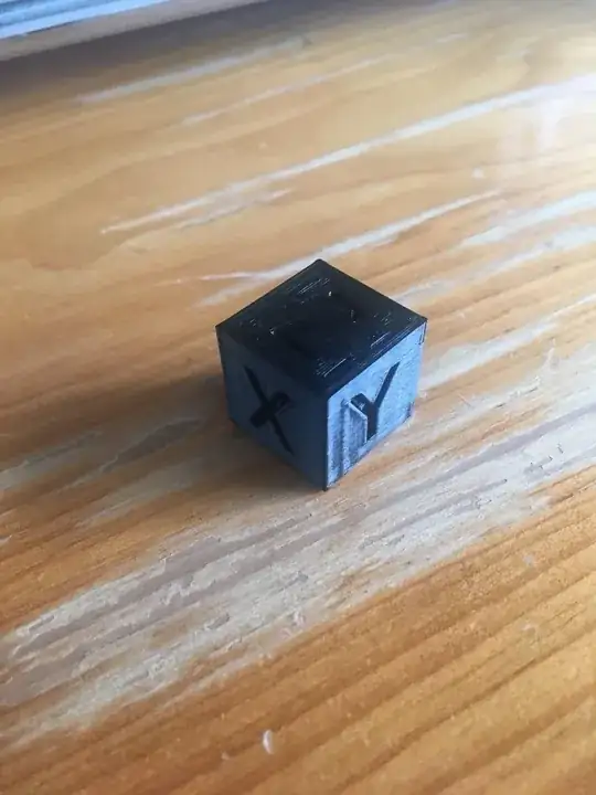

Fix was actually pretty simple.
I just removed the printer that I had setup on CURA following the manual provided by Creality (found on the provided SD Card) and started from scratch.
The one that worked was actually setting up the printer as a Creality CR-10 and then just changing the XYZ dimensions. This setup has the Origin at Center option unchecked as suggested in the comments. That's all it took...
New results: enter image description here
