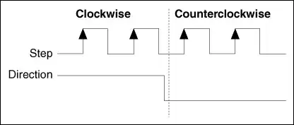

Stepper motors are usually controlled by two signals (two cables): PULSE and DIR. The PULSE signal controls how many steps the motor needs to perform and the signal itself is normally a PWM or some other form of square wave. The DIR signal controls which direction the motor is supposed to spin (clockwise or counter-clockwise), and the signal itself is just a "high/low" voltage.
Now, electronics is not exactly my cup of tea, but I would suggest what is happening is that the DIR signal of the broken output is stuck on either the high or low voltage (you can test this easily with a tester).
If I am right, the likely culprit is either a dry joint (so a joint that does not let electricity pass and keep the DIR signal in its low state), or a short (so a place where voltage at "high" level is allowed to get onto the cable carrying the DIR signal). These kind of problems are typically related to poor soldering of the connectors, or to bridges between the pins of chips. You can visually inspect your board for such problems.
