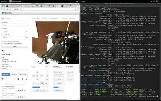

Here's a screenshot of my ssh session and my OctoPrint interface for context:
Screenshot of ssh session and OctoPrint interface
