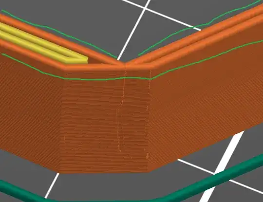

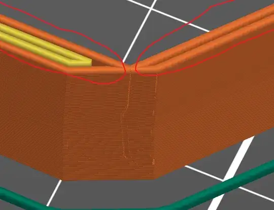

I have a model that has an extremely thin place, only one perimeter in width. Slicer moves in the way marked with the red line, creating a join in the very middle of the very visible flat pane. I marked it with a red line on the first picture.
I would prefer if the printer would print the exterior wall first, and leave any joining marks on the interior only, as marked with a green line below. Is there a way to achieve this?
I am using PrusaSlicer and Orca, but I'm ready to try other slicers if they can do it.
Model is cable-cover.stl from the Galileo2 project. Older version, because I have another issue with the current one.
What I don't like
What I want
Note: For Cura, Orca and Prusa, Outer / Inner wall is a different distinction. On the pictures, all orange ones are classified as outer walls, and yellow ones are inner. The inner-outer or outer-inner distinction does not change the effect. That's why I am using "exterior wall" and not "outer wall" in my question.

It's not possible to have such fine control over the path generation, as far as I know. (Slicers don't really know what your “exterior wall” is.) In order to get a seamless junction you will need to fit in two extrusion widths, which you could do by either:
  • Slightly thicken that part of the model on the inside (if this will not create clearance issues). You can insert boxes in PrusaSlicer which might be able to do it.
  • Use a smaller nozzle.
