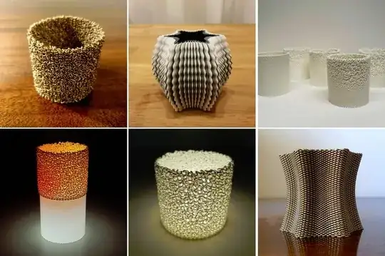

Alternatively, if you have greater skills and understanding than I, you may find Full Control to be a suitable solution. It is not modeling software, nor is it a slicer. One creates g-code based on parameters provided to the program which allows for models beyond the reach of conventional modeling programs. Images from linked site:
Full Control Gallery page
