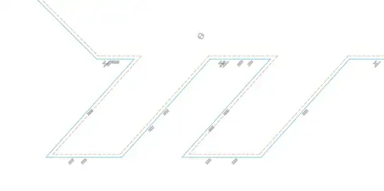

This can require to create a whole new model, with slightly altered ratios between items. Look at this example:
A complex contour and its inner offset in dashed line
As you see, some sections - especially the diagonals from bottom left to upper right - have the identical length to the line they are offset from, others are longer and others shorter. if you have the design-sketches in a STEP file, it's as easy as defining an offset and re-extruding the shifted item.

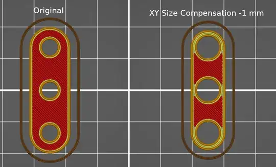

Many slicers can do this directly:
  • PrusaSlicer: Print Settings -> Advanced -> XY Size Compensation
  • Cura: Print Settings -> Horizontal Expansion
Setting a negative value will move each wall inwards along its normal.
Example in PrusaSlicer
