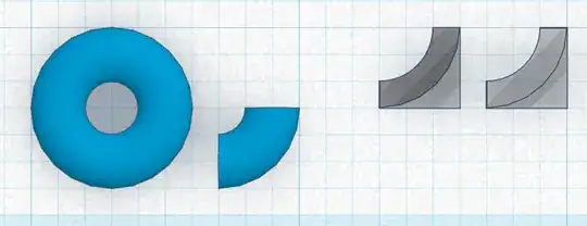

I have planned a simple object in TinkerCAD from a box with radius set to 1 mm.

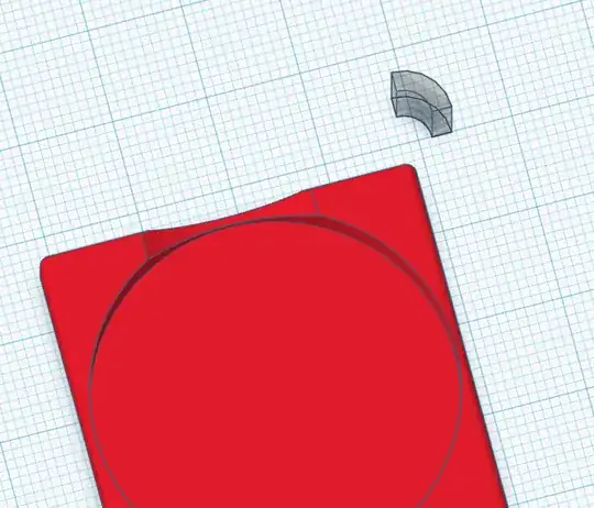

However I would need to get a 3 mm rounding on the vertical axis, therefore I have added a quarter circular eraser.
Please see both of these in this shot:

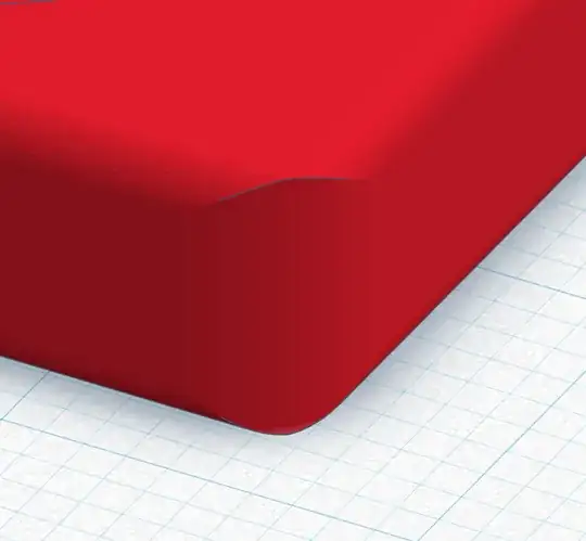

Now it's time to round the red one:

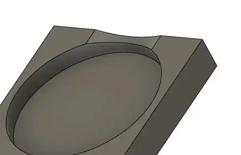

Looks good from top-angle:
But it's not rounded properly from other angles:
I wish to maintain the 1 mm rounding on the whole edge, how can I do that?

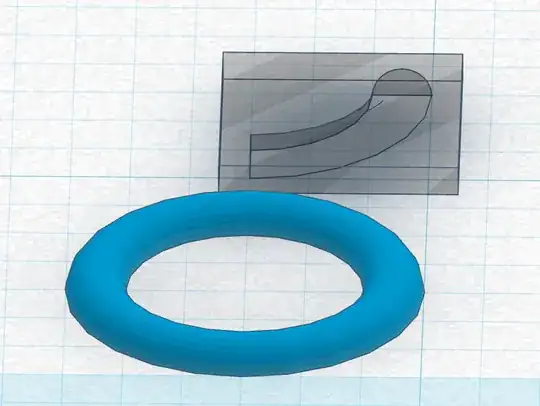

1.) Inverse ring eraser: almost good, but I would need 2 mm width, and 3 mm outer radius which is impossible (for a ring).
2.) Inverse half sphere: not good, as it's not the shape I need
Finally

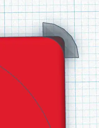

I succeeded with a "hack": ring with 4 mm width and 6 mm radius, then scaled back to 50 %, making it 3 radius and 2 mm width. Then create variuos inverse-quarters from it (eraser) and tune them even further removing unnecessary halves:

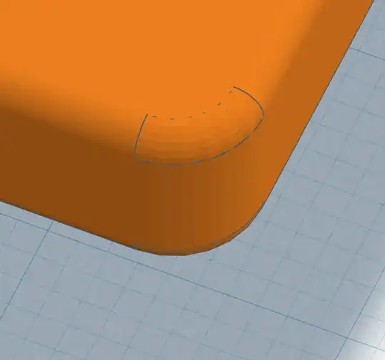

Using these erasers I could finally reach my goal:

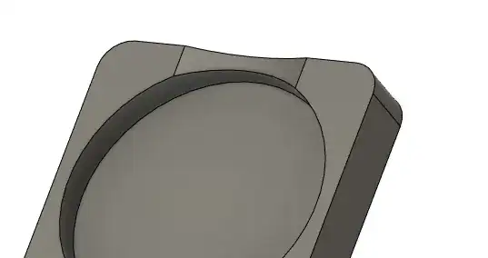

TinkerCAD is a fine tool for simple designs, but when you need to fillet or chamfer corners, this involves too many actions where you cut out the parts to get the requested fillet/chamfer. It might be interesting to save time to move to a different design tool.

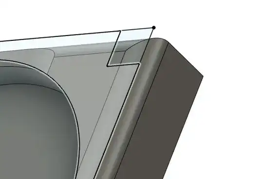

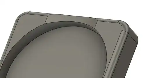

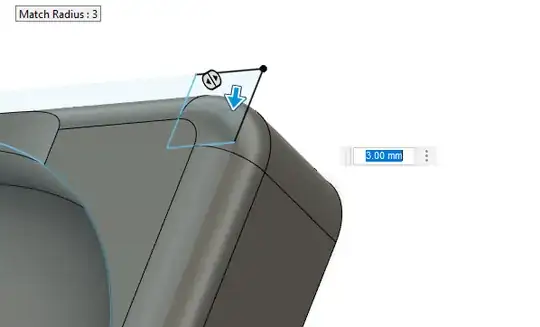

This geometry is recreated in a few minutes in e.g. Fusion360, considering this is a simple design, you need to change the order of the actions to fillet the object properly. Fillet the corners of the box prior to filetting the box itself:

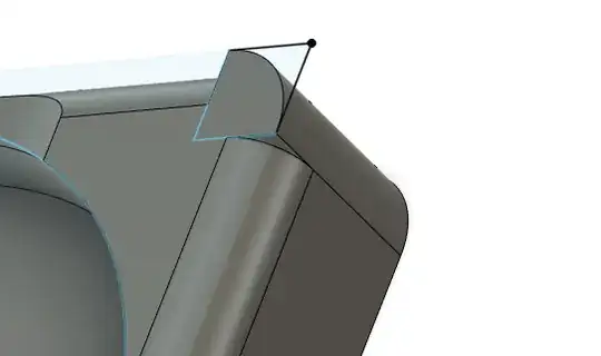

In case the design is way more complex an alternative solution would be to join a cube in the corner and round that:
