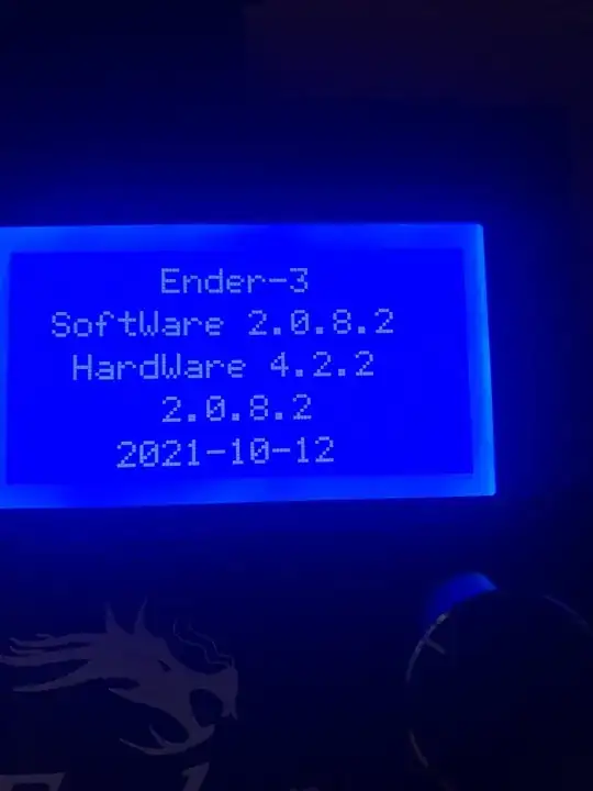

My Ender 3 is showing SD Init Fail when the sd card is inserted. I tried rebooting, reformating the card etc. At first, I thought the card is damaged, so I bought a new card. Still the same. I can use the card with the computer without any problem.
Also, I tried to print from Cura 5.3.0. But the printer is not detected.
What could be the reason? Since the SD card is not detected, I can't even flash the firmware SD Init Fail Printer Info
