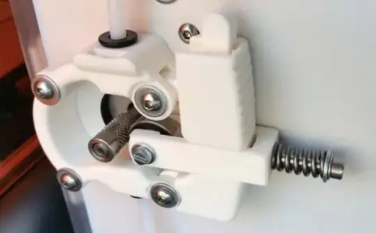

I'm working on converting an Ultimaker 2 Go to use 1.75 mm filament. So far, I have replaced the bowden tube, replaced the feeder with this one: https://www.youmagine.com/designs/alternative-feeder-1-75mm-version#information, and changed slicer/machine settings.

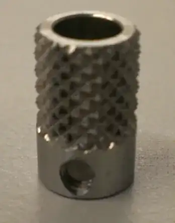

An issue I am having is grinding at regular intervals, causing severe inconsistent extrusion. Messing with the feeder tension does not do anything. So, I am wondering if upgrading the hotend to an e3D V6 will solve it. Is there anything else to consider? enter image description here I also wonder if the problem has to do with the knurled drivegear. Would this work fine with 1.75 mm filament?

Figured this out a while ago, but I thought I might as well update this.
So the issue was simply there was not enough tension, and that pretty much solved all the problems. I also did end up using an E3D v6 1.75 mm hotend.
Right now, I'm working on making it print faster. I am using klipper on a Raspberry Pi Zero W, and I'm playing with different fan ducts to improve part cooling.
