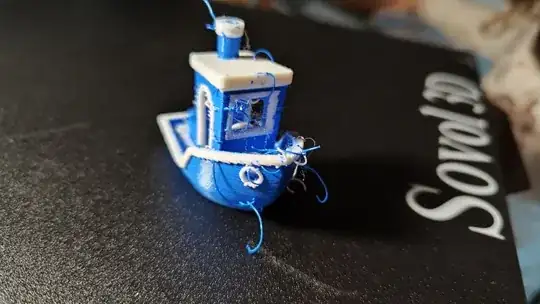

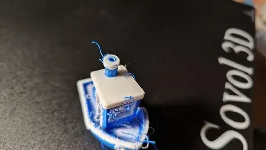

I've just got a brand new Sovol SV04 IDEX printer. After struggling for days on bed levelling, I came out with an almost decent alignment. So I printed the well-known boat to test a dual print.
Here the results:
enter image description here enter image description here enter image description here enter image description here

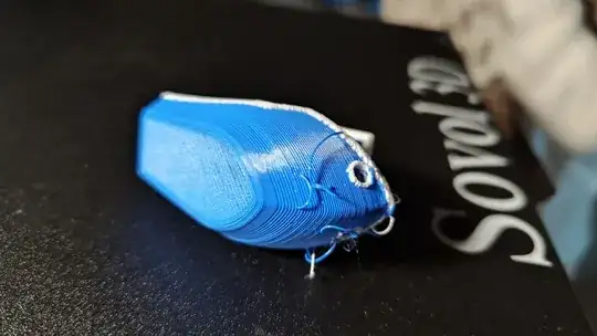

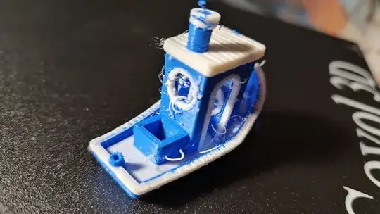

As you can see it's a complete mess. There are tons of failures. I used all the default settings for SV04 and the PLA they put inside the pack. Here what I see:
  • the only thing that worked almost flawlessly is the first layer (!)
  • there are a mis-alignment (wrong offset?) between the two nozzles
  • the layers are not "glued" together
  • little oozing (inside the cabin)
  • stringing and, I don't know how to name it, a lot of "filaments" floating around, I guess when one of the nozzle start/end printing (switch color)
  • again, not sure how to name it, very poor precision (over extruding?) for example in the blue part of the chimney
When I bought my Dremel 3D45 it worked out at the first try. Now I'm pretty lost among all these failures.

My experience with dual color printing comes from Ultimaker printers, which are very well tuned, for an IDEX design I'm working on I have been thinking how to solve these issues.
The poor print quality is caused by various issues:
  • Positioning, geometry To get the positioning correct you can make use of the G-code M218 where you can specify the X and Y offset for the other nozzles. Your first/default tool/nozzle is T0, the generic G-code is M218 T<index> X<offset> Y<offset> Z<offset> where you substitute the strings including the angle brackets (omit options you don't want to change) for the respective value you find from test prints (printing directional lines with multiple tools, X and Y) or finding the correct Z-offset for each nozzle. See also Z-Offset Multiple Heads on Tool Change.
  • "Strings" Technically this is not the well known defect called "stringing", your strings are rather thick and hint to incorrect handling of the filament retraction/extrusion (e.g. oozing due to prolonged exposure to high temperature when in idle state?) in your tool change script. It also may be very beneficial to print a sacrificial color changing (priming) tower.
