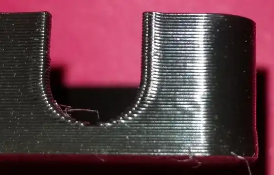

Now I have an issue where none of the dimensions on my prints are correct. I am printing a housing for a circuit board so the dimensions have to be correct or the circuit board will not fit. X, Y, and Z are all undersized. Worse yet, the first 3 or 4 mm in the Z-axis layers are squished. It's like elephant's foot on steroids. I attached a photo.
So the X and Y dimensions of the print are oversized at the bottom due to the elephant's foot but are undersized at the top. The Z-axis dimension is way undersized because of the squish.

Photo of a 3D printed model with the lower layers larger than the upper layers
