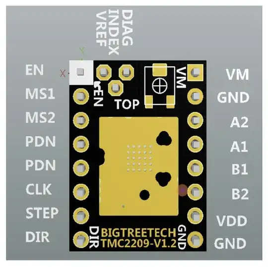

Using the BIGTREETECH PCB version of the driver:

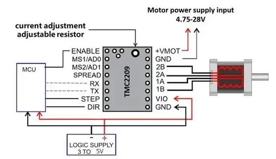

I plan to attach the enable pin to PD0 on the SKR, MS1, and MS2 to ground, UART Tx/Rx to the first PDN as detailed in the manual, VM to the power supply, GND to the power supply, A2/A1/B1/B2 to the motor, VDD to a 3.3V pin from the SPI 1 block of pins on the SKR, and GND to ground.
I think this makes sense as the driver runs in UART mode - it is set to 0x0 by tying MS1 and MS2 to ground - and my present understanding is that in UART mode the CLK, STP, and DIR pins are not needed. I am not 100% on that point so I could be wrong there. If I do need to add it then STP and DIR are easy, CLK would be a bit more challenging but I believe UART does not require a clock signal.

I have the same idea on the same board, but I think to stay with the DIR/STEP mode first. The CLK is useless for the DIR/STEP mode, then I suppose that it is useful for UART mode. But this datasheet is very strange, often there is Rx and Tx UART close to STEP pin STM2209 wiring
When I read the Bigtreetech documentation from your link, only one wire is used for the UART (Rx/Tx). This is strange, or it is to be compatible with other driver and the CLK is useless.
I never used the TMC2209 with the uart, only in STEP/DIR mode and directly drove with a Raspberry Pico.
