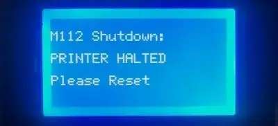

Recently, I've installed a new BIGTREETECH SKR mini E3 V3.0 board on Creality Ender-5. Previously, I was using SKR mini E3 V1.2 board, but it broke down and I had to replace it. I connected new one exactly like the previous board and calibrated the printer. Everything seemed to be working properly.
Now, I'm getting unexpected M122 errors while printing from OctoPrint:
M122 error on printer's display

This checksum mismatch error appears randomly at different stages of printing, but always around 30000 line.

I suppose that the problem is in the connection between the printer and OctoPrint. What can cause this error to happen?

According to Marlin docs, these checksum mismatch errors were due to the baud rate being set incorrectly.
The serial communication speed of the printer should be as fast as it can manage without generating errors. In most cases 115200 gives a good balance between speed and stability. Start with 250000 and only go lower if “line number” and “checksum” errors start to appear.
Lowering baud rate solved the problem.
