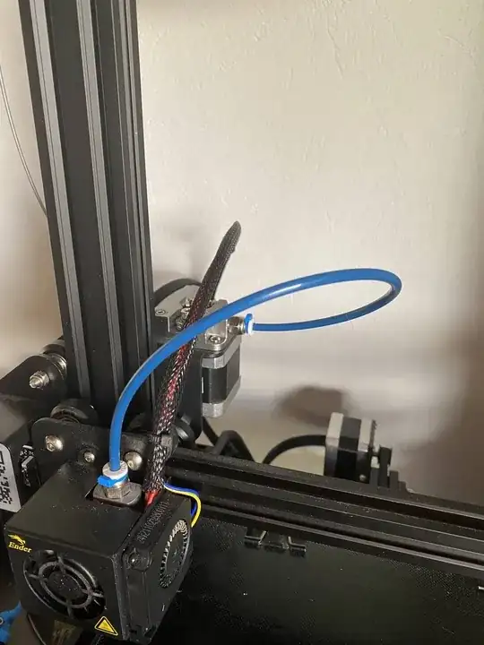

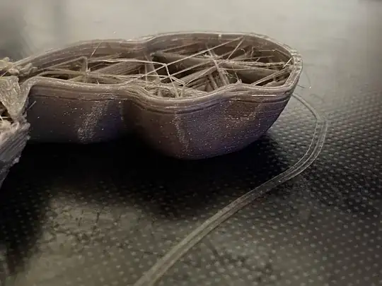

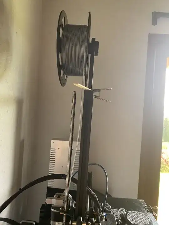

I have an Ender 3, I changed its extruder for one metallic one. In my last prints, I am getting issues at the same height. The extruder can't pull the filament in for that z position. I cleaned the Z axis, applied oil, and adjusted the eccentric nuts. I have minor improvements but still have many issues with my prints. I am thinking of changing to double z-axis, but I'd like to use my printer now.
This is my printer. enter image description here enter image description here
