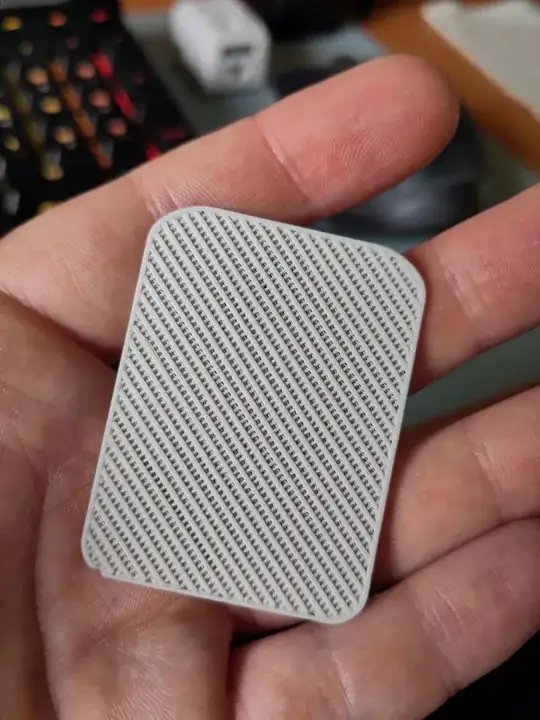

The raft prints perfectly:
Photo of a printed raft

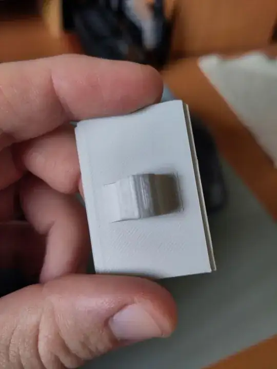

Then when it starts the first few layers of the actual print it extrudes a bit of material which then hangs from the nozzle and is dragged about the surface of the raft before stopping as more material is extruded. So when the print finishes the first layer looks messy like the one below:
Photo of the first layer of a printed model showing printing errors

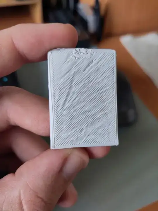

But everything after the first few layers is perfect for example the top of the same print:
Photo of the layers after the first of a printed model that doesn't showing any errors
