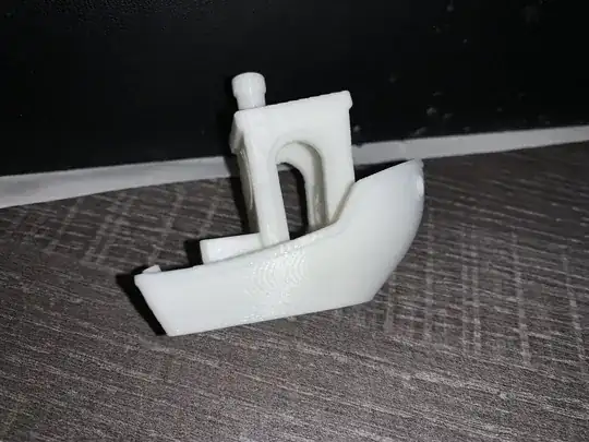

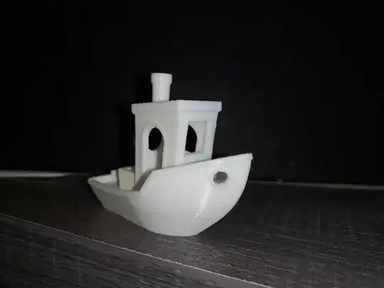

Here are some pics of my last good print:
Good benchy 1
Good benchy 2

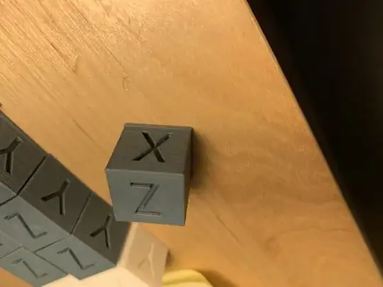

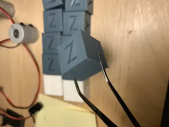

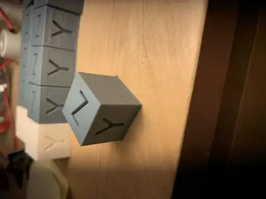

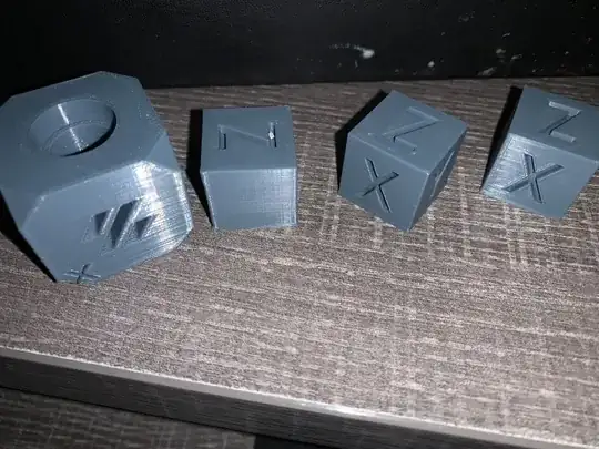

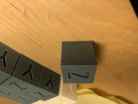

Ever since completing those upgrades, I've had uneven horizontal lines on my prints.

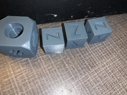

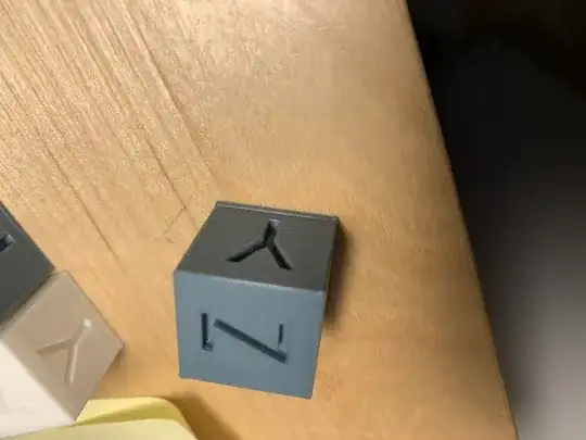

Horizontal Line 1
Horizontal Line 2
Horizontal Line 3
Horizontal Line 4
Horizontal Line 5
Horizontal Line 6
Horizontal Line 7
I've tried so many things, it's unbelievable. I've printed hundreds of calibration cubes and have adjusted many things.

I had the exact same-looking layer lines, and the problem was multi-factorial, but mainly in the Y-axis concentric nuts being too loose. In the Ender 3, the Y-axis wobbles very easily because it only has the thinner rail, the Ender 3 pro has the wider 40x40 aluminum rail on the Y-axis and it makes a world of difference. It sounds like you have dealt with this, just make sure to double-check that they are indeed as tight as recommended by CHEP.
The other issue was the extruder motor shaft/brass geared wheel that is on the shaft. If the motor shaft is slightly warped or the brass gears are worn or some of the gears are full of filament, etc., you will get a consistently uneven extrusion that gives weird layer lines; I had to replace the gear.
Finally, the end of the X-axis that does not contain the lead screw came way too tight from the manufacturer, which leads to uneven lines. This was not apparent from simply moving the gantry up and down. It required taking apart the X-axis gantry so that the wheels on that right side were independent of the lead screw side and then adjusting those concentric nuts so that the little 3-wheel part would glide up and down the rail with no resistance at all, and then reattaching it to the rest of the gantry. It is a different technique than tightening the other concentric nuts because you don’t care if a wheel seems too loose, just that it flows up and down the rail (I wish I had the time to find the YouTube video that explained this technique because it solved the last of my problems). I know you are waiting for a second lead screw but could try this adjustment while waiting.
Finally, you said that you have changed nozzles, but where are they all from the same company and batch? I got a batch from Amazon that all seemed to give me gimped prints so changing the nozzle to one from a different company might still help.
Good luck.
BTW, I am also using the skr V3 with no problems, in one Ender 3 printer (other upgrades are just Capricorn tube and filament runout sensor) and the other Ender 3 has the original 8-bit board and they both print about the same quality with regards to layer lines - which is similar to your original pictures.
