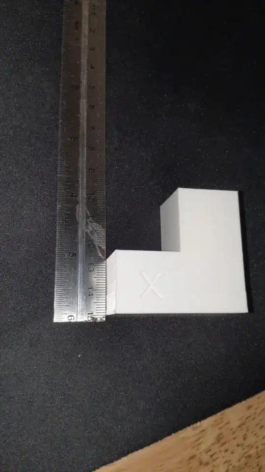

This calibration block should be 50 mm high, it's 47 mm high and the 3 mm are lost in the first 25mm step:
3D printed calibration model with ruler next beside it to show the irregularity
