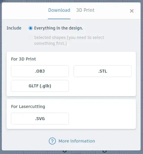

When I export a model from www.TinkerCad.com I get these options: .obj, .stl, .glb. enter image description here

STL and OBJ are formats that define a surface through trigons and a waveform respectively - to make the export work, TinkerCad runs a boolean union operation first. Without this, it would run into the problem of having bad surface geometry - a flaw that happens still when the boolean joining fails properly.
GLB is a container for gITF files and can store file hierarchies as well as cameras and animations. However, even if the structure would allow having all the bodies, TinkerCad does run a boolean union before it.
As a result, you'd have to physically separate parts of the item that are not to be joined from one another as in an explosion diagram. That way the boolean union would result in each part being separated and exporting as separate shells.
Separating Shells into models
If you have an item from TinkerCad that has multiple separate shells, you can open the STL or OBJ in a program like Meshmixer and run a Separate Shells operation. Then you can export the parts from that program as separate files that can be imported into other CAD or 3D-Design software - or sliced directly.
Re-CADing the models
If you have your parts exported and separated, it would be very beneficial to properly CAD them in a program that allows STEP files. For this you'd simply import them into a program and use the 3D Model from TinkerCad as a model to design around.
Fusion360 does allow to import STL and OBJ as a mesh, though isn't the best to edit it.
FreeCAD, an open-source alternative, does allow the import of STL and OBJ too and has a Linux distribution.
