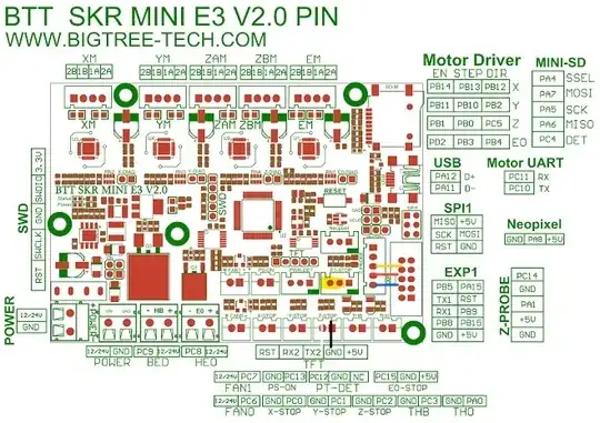

Wiring Diagram
I used this diagram to wire the sensor:
Wiring diagram for BigTreeTech SKR mini E3 board

It seems from these statements that the answer to your question is: something got damaged in the SKR board. Replacement is probably the only way.
There are however some home made optical/servo proves you can use instead of the BLTouch. They deploy a pin via a servo and use optical endstop for detection. They are reliable and require minimum wiring so that you can reuse the damaged SKR.
You can also try the quickdraw probe by Annex Engineering.
