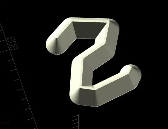

In OpenSCAD you could create a bevel using the minkowski transformation by transforming the curve using tapered shape such as a pyramid or as I do below a tapered cylinder:
minkowski() {
linear_extrude(1) import("drawing.svg");
cylinder(h = 20, r1 = 10, r2 = 1); }
Example result in OpenSCAD
