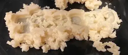

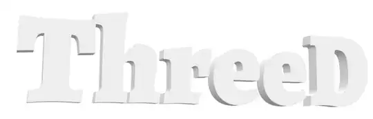

Also tried to print a word created Blender (MacOS), exported to STL, imported to Ultimaker Cura where it was sized and positioned, sliced and exported to a .gcode file. That printout seemed to be a mold of the object as opposed to the object itself.
Attached are two images, the 1st shows what was intended to print. The 2nd shows what actually printed.
What should have printed
What actually printed
If you can see past the globs and blobs, and look closely, you might be able to make out why it looks to me like a mold instead of the intended item.

Cura contains a few different so-called "special modes" which changes what the software does with your STL. One such special mode is Mold mode which, instead of recreating the object, creates a mold for the STL. It appears you may have that setting turned on, so disabling it will cause Cura to work as intended.
