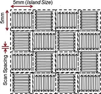

Scan spacing
Within each of the ‘islands’, simple alternating scan vectors are used with the spacing between these vectors defined as the ‘scan spacing’ and the speed with which the laser spot moves across the surface defined as the ‘scan speed’.
Source

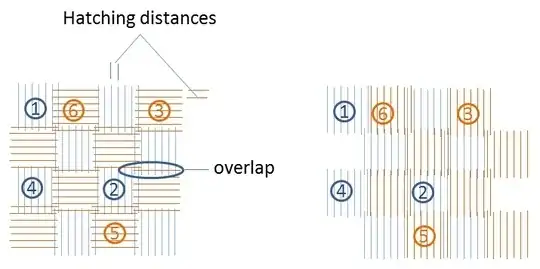

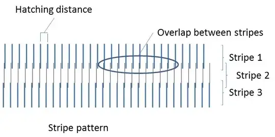

Hatch distance
The stripe pattern is a band defined by the scan vector width (ie stripe width), the hatching space between adjacent tracks and the scan direction as well as the overlap with the neighbouring stripes
Source
