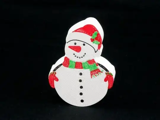

One option to create the tag you require can be accomplished with a single extruder and a bit of manual intervention.
I've performed the sequence of steps from a Thingiverse creation that resulted in a box lid for a gift card box. It's a single layer of multiple colors placed on the print bed, then consolidated with a backing layer.
For your card objective, the single layer provides the contrast and you can determine easily how thick you wish the remaining portion to print.
snowman box lid
The detail level is reasonably good, limited to the printer nozzle and specifications. A glass bed or similarly smooth surface bed will provide optimum results. As 0scar suggests, a 3D printer in the US$100-150 will likely suffice, but check reviews and forums for troublesome products of such a low price.
