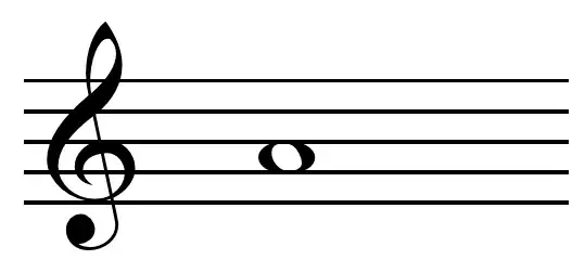

Let's take a simple example: a 440 Hz tune is generally considered to be the A4, aka concert pitch a or A440.
It could be encoded in a various ways. The probably oldest is to encode it as a note in violin notation, which then could be reproduced by anyone using a properly tuned instrument. The actual result depends on the instrument used as much as on the skill of the player. Each instrument thus might decode this encoded note differently, based on the physical setup of the instrument. Each instrument automatically creates the appropriate overtones.
A440 encoded as a note

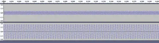

For a physicist, the pure sound is encoded as just the notion of 440 Hz and some amplitude to balance how loud it is. With those instructions, he'd be able to set up a device that has these creates a 440 Hz tune. To generate the sound and feel of an instrument, the encoding for a physicist would need to contain all the overtones that are to swing with this one sound.
880 Hz overtone at 0.2 Amplitude and 440 Hz tone at 0.8 Amplitude

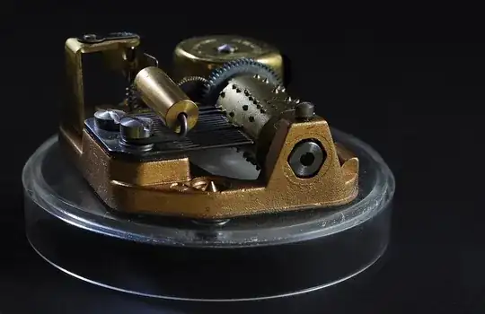

Peg-Cylinder
A very simple method would be to go back to encoding and check out the note notation but limiting the length of notes to one unit. Encoding music this way results in pegs or ridges on a cylinder, which then can be used to actuate a mechanism to decode the music and create sounds like in a music box. In a music box of this kind, the demand for accuracy is about 3 to 5 magnitudes lower than in vinyl records: we speak about a tenth of a millimeter to centimeter scale.
Such a Musical box or noisemaker can be easily printed and is pretty much a rumble strip coiled around a cylinder. The length of the sample is determined by the resolution, playback speed and diameter of the cylinder while the complexity is determined by the rows of pegs of it: a noisemaker is pretty much a 1-note, high speed, music box. Typically, one rotation stores about 25 to 30 seconds. Typical examples would be the first part of Für Elise, or the Marble Machine (Between second 30 and 35 the encoding wheel rotates 1 fifth). Some barrel organs also use the peg method, like one can see here. With some trickery, one cylinder could be used to encode multiple parts that play one after another once a rotation is done by and silencing some parts of the machine depending on an extra encoder, like this 3-part Für Elise music box.
